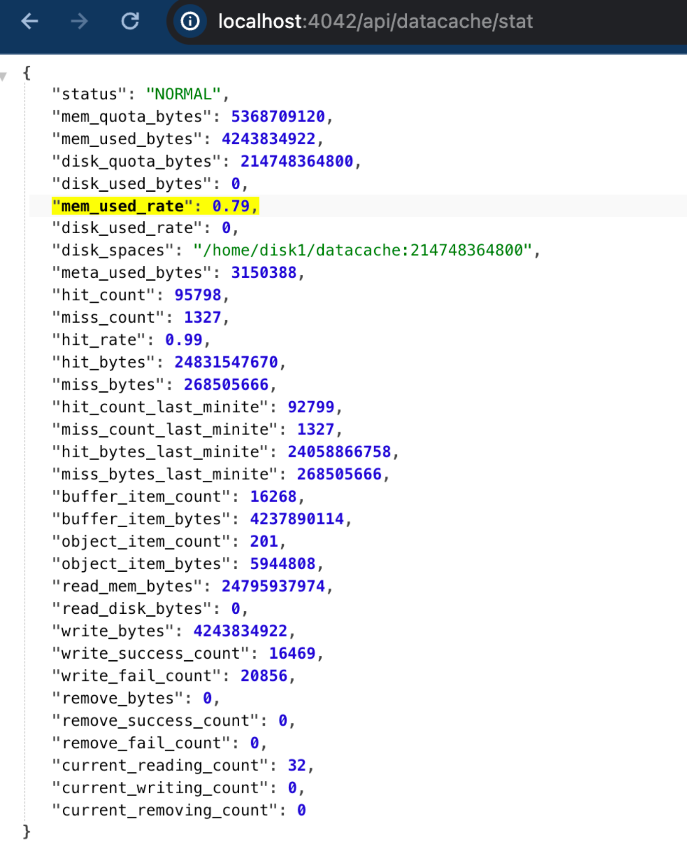

  • You can access the BE Web Console (http://${BE_HOST}:${BE_HTTP_PORT}/api/datacache/stat) to check the current Data Cache quota, hit rate and other metrics. You can confirm that Data Cache is enbaled if disk_quota_bytes or mem_quota_bytes is greater than 0.
Data Cache FAQ - Web Console
