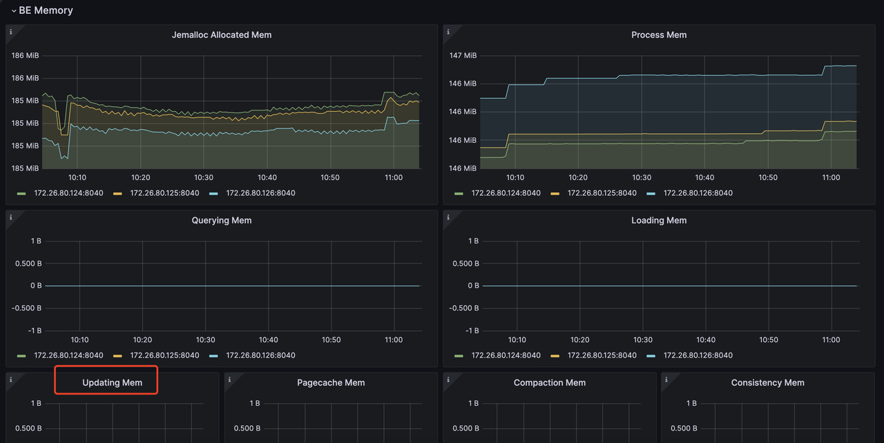

update item in mem_tracker record whole memory used by Primary Key table, such as primary key index, delete vector and so on. You can also monitor this update item via metrics monitor service. For example, in Grafana, you can check update item via (item in the red box):
grafana
More about Monitor and Alert with Prometheus and Grafana: https://docs.starrocks.io/docs/administration/management/monitoring/Monitor_and_Alert/
