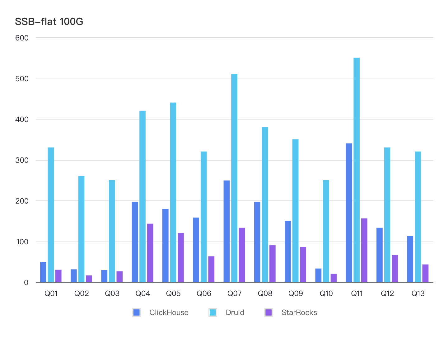

  • Among the 13 queries performed on SSB standard datasets, StarRocks has an overall query performance 2.1x that of ClickHouse and 8.7x that of Apache Druid.
  • After Bitmap Indexing of StarRocks is enabled, the performance is 1.3x compared to when this feature is disabled. The overall performance of StarRocks is 2.8x that of ClickHouse and 11.4x that of Apache Druid.

The following table shows the performance test results on thirteen queries. The unit of query latency is ms. All queries are warmed up 1 time and then executed 3 times to take the average value as the result. ClickHouse vs StarRocks in the table header means using the query response time of ClickHouse to divide the query response time of StarRocks. A larger value indicates better performance of StarRocks.
StarRocks-3.0StarRocks-3.0-indexClickHouse-23.3ClickHouse vs StarRocksDruid-25.0.0Druid vs StarRocks
Q1.13330481.4543013.03
Q1.21010151.5027027.00
Q1.32330140.6182035.65
Q2.11861163011.627604.09
Q2.2156502731.759205.90
Q2.373362553.4991012.47
Q3.11732333982.3010806.24
Q3.2120803192.668507.08
Q3.3123302271.858907.24
Q3.41316181.3875057.69
Q4.12031964692.3112306.06
Q4.273761602.19102013.97
Q4.350361482.9682016.40
sum123693926452.14107508.70
